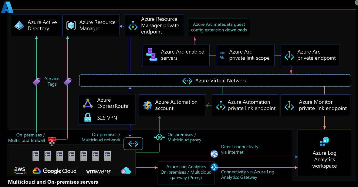

    • To troubleshoot these potential networking issues, you should be able to use something like Fiddler to help show why the CEF messages aren't being received.
    • You can also look into leveraging Azure-Arc so your on-prem server(s) can connect to Microsoft Sentinel.
    Additional Links:
    Network topology and connectivity for Azure Arc-enabled servers
    I hope this helps!
