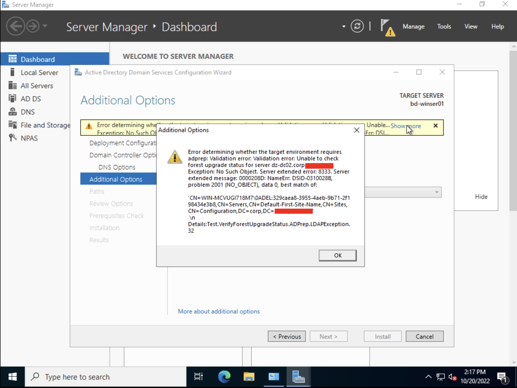

I have two domain controllers in the forest called corp.x.x. I'd like to make the third machine as the domain controller, then the problem occur as following picture.
Error event id: 8333

  2. Gary Reynolds 9,621 Reputation points
    2022-10-20T11:22:25.23+00:00
    It looks like someone may have accidently deleted the server object. The error message is referring to CN=WIN-MCVUGI718M7\0ADEL:<GUID> the \0ADEL in the name is usual the reference for deleted objects.
    You may need to restore the object before you can continue - https://nettools.net/how-to-restore-deleted-ad-objects/
    Gary.
