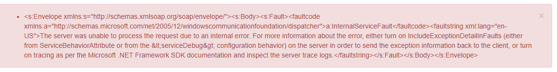

I am trying to upload Offline conversion to Bing Ads API, and each time i send a request i get the following error:
The server was unable to process the request due to an internal error. For more information about the error, either turn on IncludeExceptionDetailInFaults (either from ServiceBehaviorAttribute or from the <serviceDebug> configuration behavior) on the server in order to send the exception information back to the client, or turn on tracing as per the Microsoft .NET Framework SDK documentation and inspect the server trace logs.
Please check what is the issue? We didn't change anything at our end.

  1. Howard Chang 81 Reputation points
    2022-10-24T20:54:36.54+00:00
    I had this problem with the reporting API, and I've solve this by switching the WSDL to the singleWSDL version:
    from:
    https://reporting.api.bingads.microsoft.com/Api/Advertiser/Reporting/v13/ReportingService.svc?wsdl
    to:
    https://reporting.api.bingads.microsoft.com/Api/Advertiser/Reporting/v13/ReportingService.svc?singleWsdl
    Let me know if this helps.
    Good luck everyone.

  1. Williams, Dan 46 Reputation points
    2022-10-21T19:16:39.147+00:00
    Exactly the same issue. No changes on my side but I am now getting the same error. This is breaking some of my reports.
