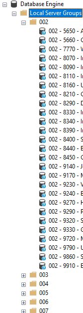

I have a Local Server Group with seven different folders in it. Each folder has a list of registered servers, and each registered server points to a specific database. I want to write a query that can be executed against all of the registered servers/databases in all seven (002 - 007) folders. My problem is that my query has a date criteria that differs depending on which server/database I am querying. For example, my code may use a date of '2022-10-14' when querying against the server/database 002-5650, but when running the same code against 002-5660 the date may need to be '2022-10-16'. Is it possible to write a query that detects which server I am connected to before code execution that I can write a case statement to modify the date in the code?
this is pseudocode...
case when connected to server/database 002-5650 then populate date variable @apl = '2022-10-14'
else when connected to server/database 002-5660 then populate date variable @apl = '2022-10-64'
end
something like that?
