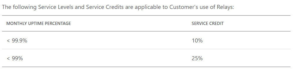

    If it is any less, here is the credit you will receive if they are down any longer than 99.9%:
    Cited from https://azure.microsoft.com/en-us/support/legal/sla/service-bus/v1_1/
