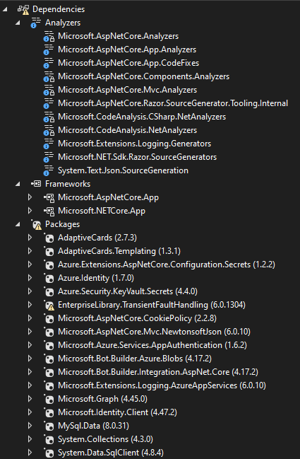

Installed Packages:

    Also, if you install nuget package 'Microsoft.Extensions.Logging.AzureAppServices' in VS, please also install the same version as the site extension 6.0.11. Different versions might cause conflicts.
