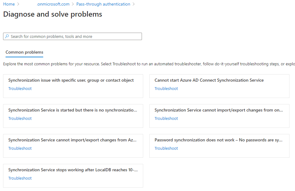

Now I'm a bit stuck because I can't find any further ways of troubleshooting. When I go on https://portal.azure.com/#blade/Microsoft_AAD_IAM/ActiveDirectoryMenuBlade/AzureADConnect then "Pass-through authentication", then "Troubleshooting" I get the following screen
which is only regarding synchronization issues. PTA is not a topic in any of those options.
Does anyone know a guide on how to further debug problems with pass through authentication?
