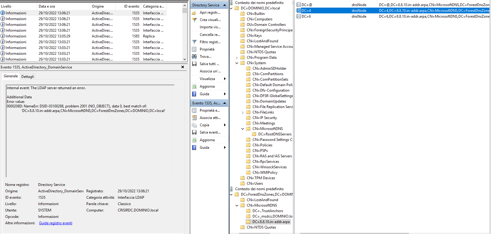

The errors listed under event ID 1535 are these:
*Error value:
0000208D: NameErr: DSID-03100288, problem 2001 (NO_OBJECT), data 0, best match of:
'DC=8.8.10.in-addr.arpa,CN=MicrosoftDNS,DC=ForestDnsZones,DC=DOMINIO,DC=local'
as well as
'DC=_msdcs.DOMINIO.local,CN=MicrosoftDNS,DC=ForestDnsZones,DC=DOMINIO,DC=local'
and
'DC=DOMINIO.local,CN=MicrosoftDNS,DC=DomainDnsZones,DC=DOMINIO,DC=local'*

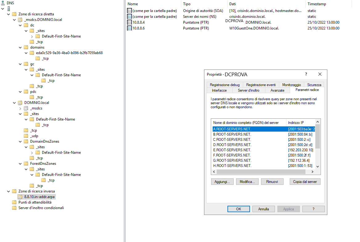

I've disabled ipv6 address ("unchecked")
I had also changed the dns server from localhost to: 10.8.8.4 and setup a reverse ip address too.

In the registry editor I've set the log level to 2, I did set also '15 Field Engineering' to '5' in order to enable Expensive and Inefficient LDAP calls to be logged in Event Viewer.
I tried to execute a LDAP query with "cn=users, dc=DOMINIO, DC=local" in the base DN fieldwith the search filter and it worked.(it's been done from the domain Host(logged as Admin) and I can get the entry).

I noticed Firewall couldn't resolve 8.8.8.8 or 1.1.1.1(when I set them as DNS forwarders) when I was connected to my Company. (I'm doing an intern)
I found that dcdiag /test:dns passed at home with my network and with no VPN.
