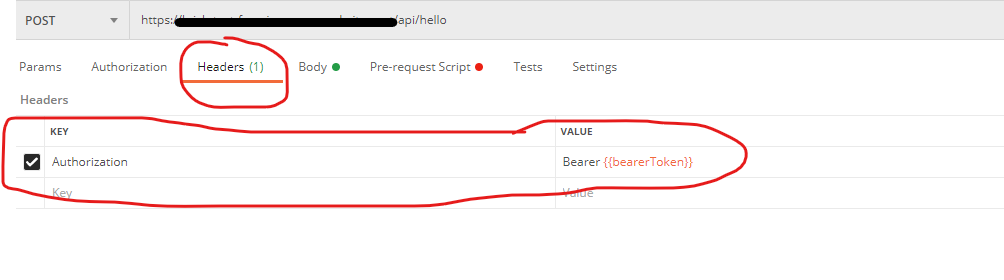

    You can leverage Postman "Pre-request script" to automatically acquire token and pass it as auth header to your API like below. Here is the script (replace the {placeholder} with your actual values).

    1. Set Authorization header to refer a global variable 'Bearer {<!-- -->{bearerToken}}' like below:
    2. Set the above global variable from pre-request script like below:
