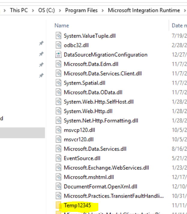

    Hello @Bhargava-MSFT @saikumar guturi
    This is issue with the new version of self hosted integration run-time . The integration run time gets updated with the newer version automatically if you enable auto update option in integration run-time.
    Please re-install the older version that will solve your issue.
    With New version of integration runtime I created a new linked service . And i provided my 'D' drive path in the host. Then i got error 'd could bot be resolved'.
    I found that by default it is pointing to below path.
    'C:\Program Files\Microsoft Integration Runtime\5.0\Shared'
    Actually i created folder 'Temp1234' under 'C:\Program Files\Microsoft Integration Runtime\5.0\Shared' .
    Then i provided 'Temp1234\' under host in linked service and i was able to make the connection.
    i'm surprised that it is looking the folders under 'C:\Program Files\Microsoft Integration Runtime\5.0\Shared' .
    Then i provided 'test1234\' under the host and i got error like
    'unable to find the path 'C:\Program Files\Microsoft Integration Runtime\5.0\Shared\test1234'
    My previous version is 5.22.8285.1. The IR updated with newer version (5.22.8312.1) automatically . Then after i started getting issues
    @Bhargava-MSFT can you please look into this issue . If this is valid can you create a ticket
