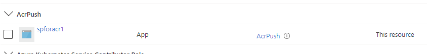

  2. shiva patpi 13,366 Reputation points Microsoft Employee Moderator
    2022-11-11T00:56:59.7+00:00
    Hello @Lee Johnson ,
    I was trying to repro your exact scenario locally with my ACR with my existing SP but not able to do so.
    So went ahead and created a new SP and tried logging in after giving ACR PULL Permission:
    ACR Pull permission for SP:
    Then I gave ACR PUSH permissions for that SP, I was still getting the same error.
    Then ran the login command again: helm registry login acr.azurecr.io --username id --password <pwd>
    followed by push:
    This time it went through successfully:
    Points to be Noted/Observed:
    -> ACR Pull permissions are needed for login
    -> ACR Push permissions are needed to push
    -> After giving ACR Push permissions , try to re-login again
    -> Wait for couple of mins to completely propagate the permissions
    Let us know if that helps !!
