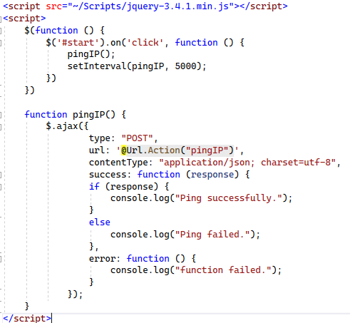

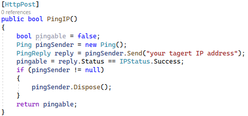

    2022-11-14T08:13:54.957+00:00
    Hi @Indubhushan
    Based on your description, if you just want to perform an operation at a fixed time interval, you can use the setInterval(func, delay) function in javascript and send an ajax request to achieve this requirement. Simple code like this below:
    For code details, please refer to the attachment: 260014-code-simple.txt.
