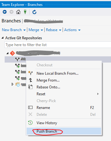

    If you want to push local branch to GitLab as a new branch, you can try to click the Push Branch option from Team Explorer > Home > Branches > find your branch and right-click it > Push Branch.
