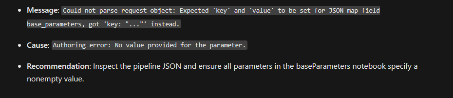

    Here is an existing TSG which calls out this issue and the possible resolution: Azure Databricks Error code: 3202
    Message: Could not parse request object: Expected 'key' and 'value' to be set for JSON map field base_parameters, got 'key: "..."' instead.
    Cause: Authoring error: No value provided for the parameter.
    Recommendation: Inspect the pipeline JSON and ensure all parameters in the baseParameters notebook specify a nonempty value.
    Please ensure that your pipeline passes a non-empty value to the baseParametres notebook, and it should help resolve the issue.
