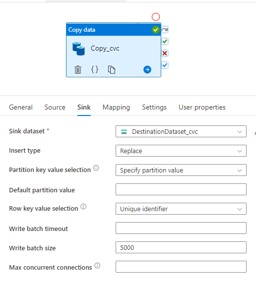

Hi Experts , I have got one of the rest API which returns 471600 records and takes around 1.5 mins to get the data . I created a ADF copy pipeline to read the data from API and insert in the Azure table . I scheduled the pipeline to run every 4 mins . The pipeline works intermittently , it will be success for few run and would fail for few . Which makes the data pull very unreliable .
Error is very generic as below
Operation on target Copy_cvc failed: Failure happened on 'Source' side. ErrorCode=JsonInvalidDataFormat,'Type=Microsoft.DataTransfer.Common.Shared.HybridDeliveryException,Message=Error occurred when deserializing source JSON file ''. Check if the data is in valid JSON object format.,Source=Microsoft.DataTransfer.ClientLibrary,''Type=Newtonsoft.Json.JsonReaderException,Message=Unterminated string. Expected delimiter: "
I know that there is no issue with the data and not sure if it pulled the data half way and hence it reports the unterminated string as on the other run it works . The data from the API is static and does not change frequently .
One of the thing i have noticed is the that in the sink setting is make the Write batch size as the higher number around 100000 then it does not work at all then i reduced to 5000 so it works intermittently .
Can anybody please help on this issue below is the screen shot of the pipleline
Any help is appreciated .
Thanks
