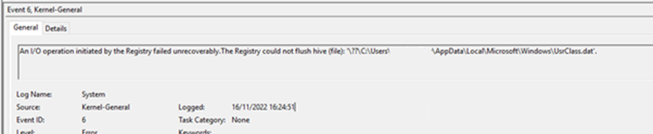

We are currently running FSLogix 2.9.8228.50276 and we are experiencing an issue where users will be working in our Citrix environment when their FSLogix VHD will be disconnected from their session on the server and the screens will go black. The user is unable to log back into our environment until I have logged off their session. It appears that the profile is being marked as Stale when it is still in use and causing users to lose work. Has anyone experienced this and is there anyway we can stop this happening?
I have investigated in Event Viewer and often we will see events such as the one below.
When I look into the FSLogix logs we can see entries like this to coincide with the user’s profile being disconnected.

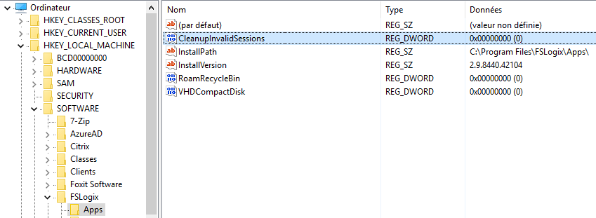

    2023-01-24T21:36:59.1966667+00:00
    If you are having this issue then turn off the CleanUpInvalidSessions key (i.e. set = 0). This key is only for extraordinary circumstances when for example the host machine has crashed. Normal operation does not need this key turned on. If the machine does crash and have issues, then turn the key on and leave it on for a day or two. Then turn it off again.
    Also note that when the key is set to off, you will probably need to reboot the machine OR log every FSLogix user off and restart the FSLogix service to get the CleanUpInvalidSessions feature to turn off.
