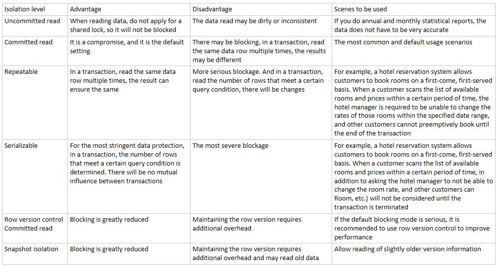

    It depends on what kind of data you want to see, or your tolerance for the accuracy of the data.
    Row version control is not a panacea to eliminate blocking and deadlocks. Before deciding to use it, the following two questions must be considered.
    1. Whether the end user accepts the running result under the line version control
    In different transaction stages, some are blocked, some read the old version value, and some can read the new version value. What behavior do you or your users expect? Do you want to read the latest version of the data even if it is blocked, or can you tolerate reading the old version? Some applications rely on the locking and blocking behavior of read isolation, such as operations such as generating a serial number. Change to version control, and the original processing logic will not work properly. So before adopting the new isolation level, be sure to do a good job of testing to ensure that the application will run as expected.
    1. Can SQL Server support the additional load caused by row version control
    When row version control is enabled, SQL Server will store the row version in tempdb. The more data is modified and the more information needs to be stored, the greater the additional load on SQL Server. Therefore, if an application is to switch from other isolation levels to version control, special testing is required to ensure that the existing software and hardware configuration can support the additional load and the application can achieve a similar response speed.
