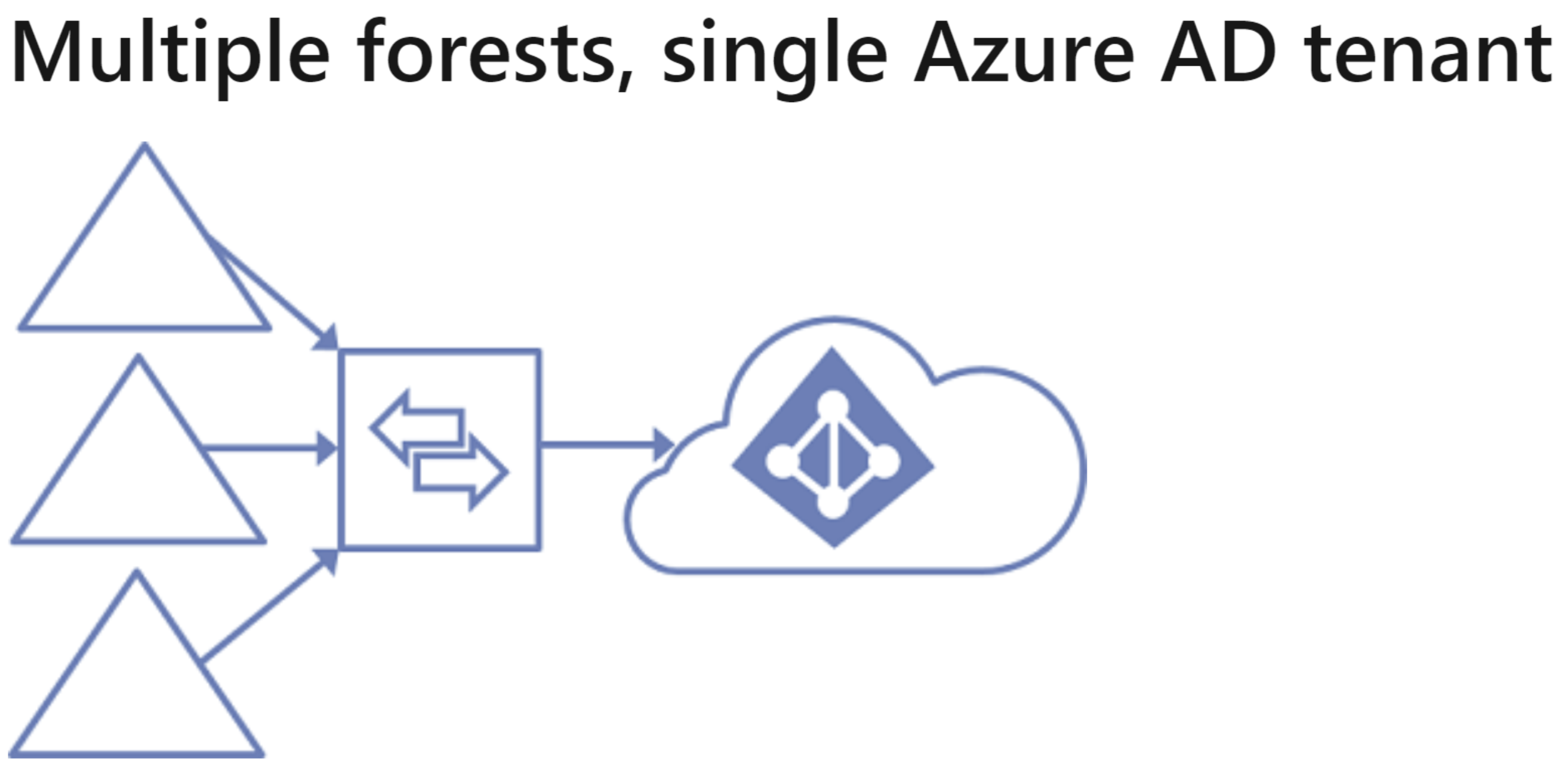

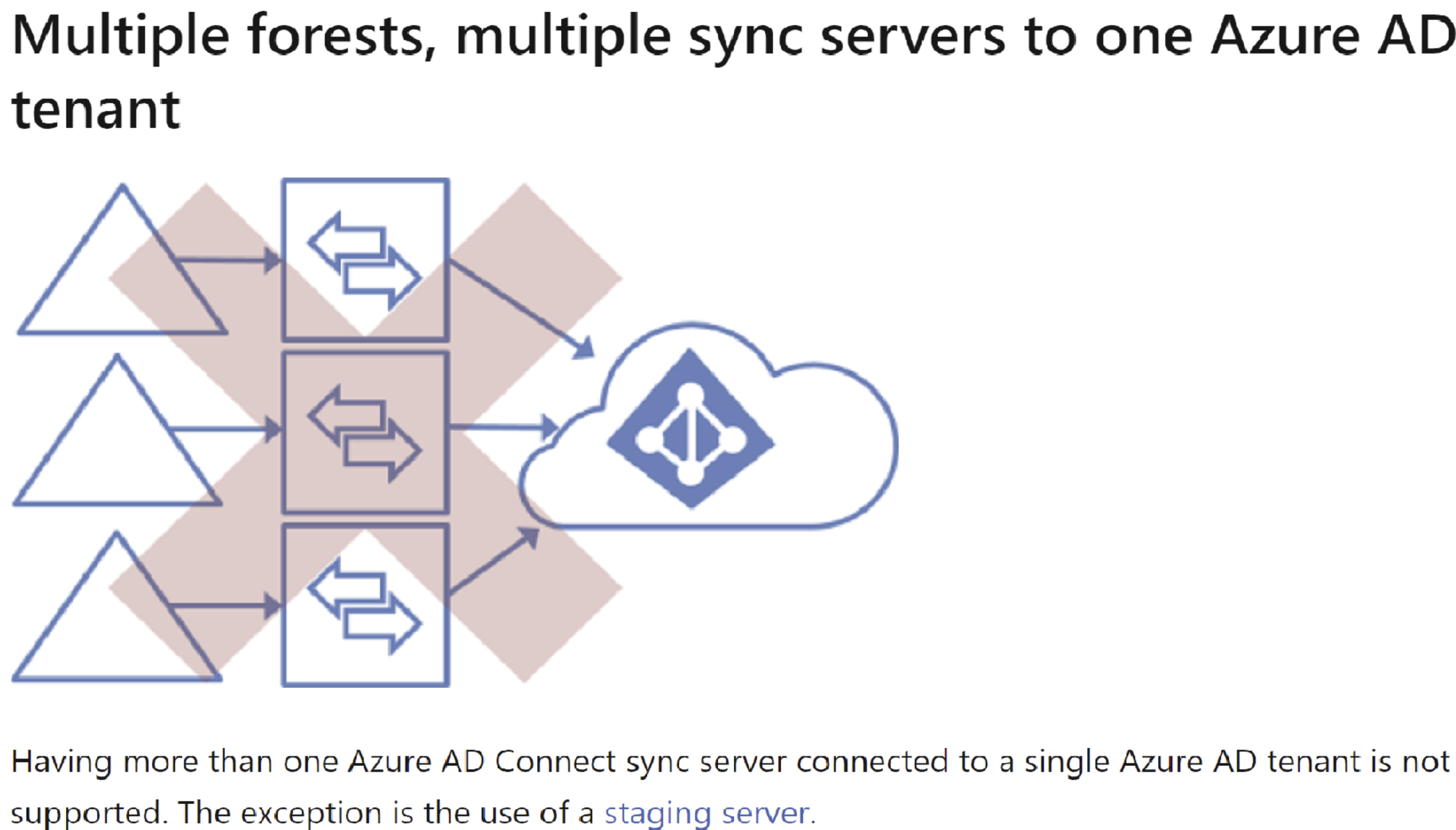

In your scenario you cannot sync multiple forests to single Azure AD tenant. You cannot configure AD connect separately in both forests and sync to single Azure AD tenant as it is not supported.
The only option is to have 2-way trust between both forests and then install AD connect in only one forest.
This will allow AD connect to talk to both forests to pull objects and sync them all to one single tenant.
Many organizations have environments with multiple on-premises Active Directory forests. There are various reasons for having more than one on-premises Active Directory forest. Typical examples are designs with account-resource forests and the result of a merger or acquisition.
When you have multiple forests, all forests must be reachable by a single Azure AD Connect sync server. The server must be joined to a domain. If necessary to reach all forests, you can place the server in a perimeter network (also known as DMZ, demilitarized zone, and screened subnet).
The Azure AD Connect installation wizard offers several options to consolidate users who are represented in multiple forests. The goal is that a user is represented only once in Azure AD. There are some common topologies that you can configure in the custom installation path in the installation wizard. On the Uniquely identifying your users page, select the corresponding option that represents your topology. The consolidation is configured only for users. Duplicated groups are not consolidated with the default configuration.
Common topologies are discussed in the sections about separate topologies, full mesh, and the account-resource topology.
