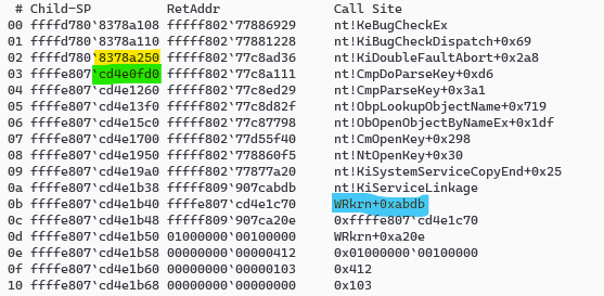

    The cause of the crash was a kernel stack overflow:
    The Windows kernel had to switch to a special stack to handle the stack overflow (that explains the change in Child-SP between the yellow and green highlighting).
    Visible on the stack is WRkrn.sys, which seems to be part of Webroot SecureAnywhere; since no debug symbols for WRkrn.sys are available, the Child-SP/RetAddr values below the blue highlighting are meaningless.
    Third party security products are often the cause of crashes and WRkrn.sys is certainly a suspect in this case.

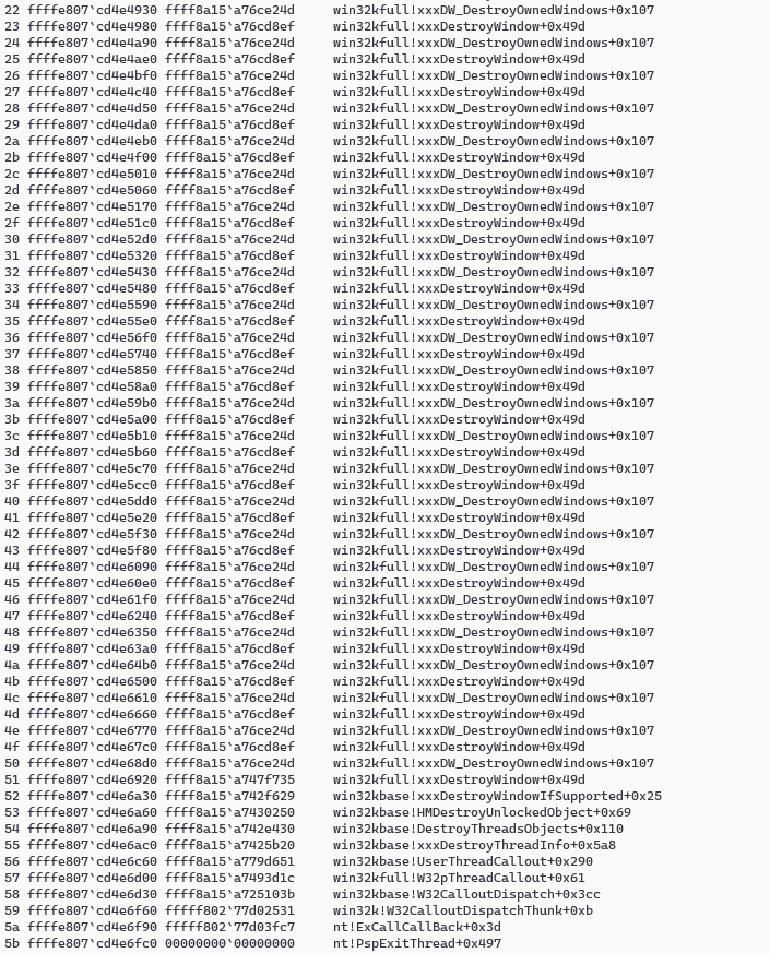

    However, a large part of the stack is seemingly taken up with recursive calls to win32kfull!xxxDestroyWindow (the current process is NextGenEMR.exe).
    I would suggest checking other dumps (if you have them) to see whether they are similar to this crash (especially presence of WRkrn.sys on the stack at time of crash and, to a lesser extent, NextGenEMR.exe as the current process).
    Gary
