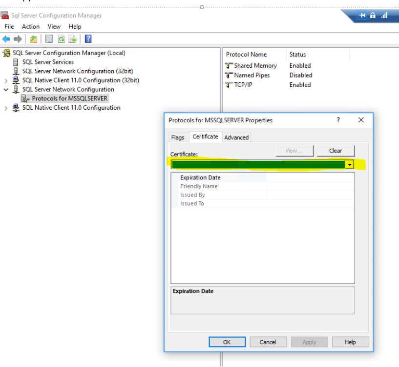

    Hi, @Janez Kuhar Thanks for your patience, Below are the steps you can follow
    login to the machine where SQL server is running and Open SQL Server Configuration Manager navigate to SQL Server Network Configuration and expand it to see "Protocols for MSSQLSERVER" and go to properties to see a new dialogue box appear as shown
    on certificates open the drop-down to verify if the correct certificate is selected or not. If no certificate is selected you can select the desired certificate. If you do not want to use any certificate, then leave it empty and move forward with the rest of the steps.
    Make a note of the name and thumbprint of the certificate that is supposed to be used.you can skip this if you do not want to use any certificate

    Once done please restart the sqlserver process so that the changes can be picked up. Please note that you may not do it immediately if you have dependencies such as the production server/critical environment.
    you can restart it at your convenience and verify to see if the refresh issue is fixed or not.
