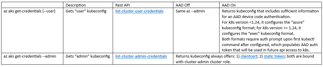

    Wanted to share below details to clear with AKS’s authentication concepts, which is also described here.
    Ref:
    list-cluster-user-credentials
    list-cluster-admin-credentials
    clientcert
    static token
    Below are the responses for your queries.

    Admin token also works, note however that admin account can be blocked via disable local accounts. Admin accounts has its own problem, namely: 1) the permission is too broad for automation and can easily be abused; 2) Difficult to rotate on security breach.
    I shared this in my previous response to extract both admin tokens and service account tokens.
