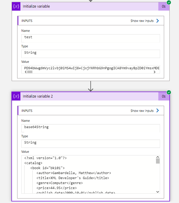

I used base64() function and tested with 2400 bytes and this works fine and returns the encoded version of the string as expected.
I need to decode the message using base64ToString(PD94bWwgdmVyc2lvbj0iMS4wIiBlbmNvZGlu). and this returns "<?xml version="1.0" encodin" bytes size is 36 bytes
However, this base64ToString(PD94bWwgdmVyc2lvbj0iMS4wIiBlbmNvZGluZ) returns an error when the string size is 37 bytes
What are the max bytes allowed to use in base64ToString()? why is there a limitations in base64ToString()?

    @Anonymous Thanks for reaching out. I couldn't observe the same behavior at my end. I have tested which this data while is more than 5KB data and couldn't observe any issue. The max size would be the maximum size of string in C#. Can you share your workflow and how you have initialized the value and in which field you are saving the converted value. In case if your encoded string is invalid that the base64ToString function will through the error that "The value cannot be decoded from base64 representation"
