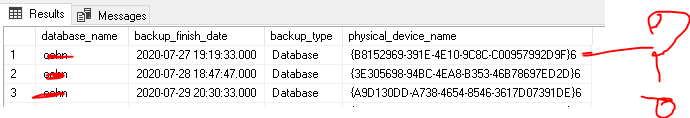

Hi Expert,
I am not sure in which location the database backup is performing. I ran a query and it returned the following output. And also I don't see any database backup job in the SQL Server agent. But the backup is performing every day. Please look into the attach screenshot

  1. m 4,276 Reputation points
    2020-09-29T03:30:45.04+00:00
    Hi @Zahid. Ahamed ,
    Please execute code as next to check your device type:
    SELECT
        database_name,
        backup_finish_date,
        CASE msdb..backupset.type
            WHEN 'D' THEN 'Database'
            WHEN 'L' THEN 'Log'
        END AS backup_type,
        physical_device_name,
     device_type
    FROM msdb.dbo.backupmediafamily
    INNER JOIN msdb.dbo.backupset
        ON msdb.dbo.backupmediafamily.media_set_id = msdb.dbo.backupset.media_set_id
    --WHERE (CONVERT(datetime, msdb.dbo.backupset.backup_start_date, 102) >= GETDATE() - 1)
    ORDER BY database_name,backup_finish_date
    Quote from this doc. :SQL-Server-physical_device_name-in-the-Backup-log-shows-GUID
    Please verify these rows have value 7 in the column "device_type" or not. The value 7 means "Virtual device". These rows are actually very useful for monitoring, for example it help to know that the Virtual Machine backups are running full database backups on a SQL Server instance. there's no trace of these backup files since they are above the scope of the virtual machine (above the level of your control) - these are triggered by the host,meaning azure in this case (Hyper-V or VMware for example triggers these).
    In conclusion: These backups are not related to our backup in the level of the instance.
    BR,
    Mia

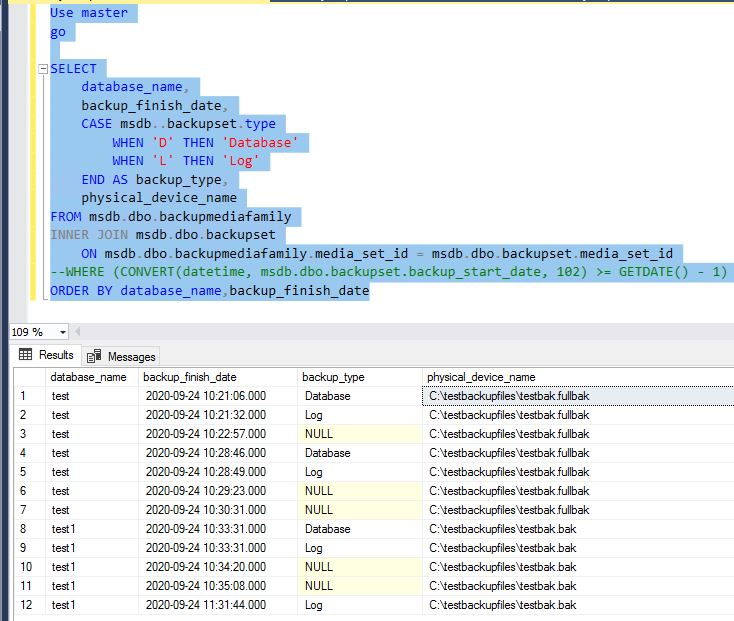

    2020-09-29T02:16:42.427+00:00
    Hi @Zahid. Ahamed ,
    Execute code as next:
    Use master
    go
    SELECT
        database_name,
        backup_finish_date,
            WHEN 'L' THEN 'Log'
        END AS backup_type,
    BR,
    Mia

  3. Zahid. Ahamed 41 Reputation points
    2020-09-29T02:35:29.267+00:00
    Thanks for replying. I don't know about this backup device. I ran this above query and it returned the below output:--
  4. Shashank Singh 6,251 Reputation points
    2020-09-29T06:05:31.87+00:00
    @Zahid. Ahamed The physical-device_name as Hexadecimal number represents a tape or Snapshot backup not a backup on local or shared disk. So you would not be able to find it on local disk. The backup is either being performed by some third part backup tool taking backup on tape or some backup tool which takes snapshot backup. In this case you need to get in touch with backup team to get information about the same. Please see similar answer given by me on Stackexchange Thread
