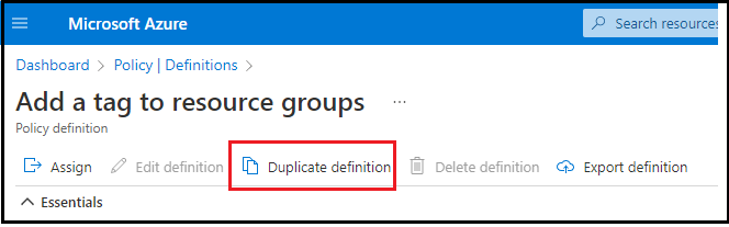

    1. In Azure Portal --> Azure Policy, select Definitions
    2. Search for "Add a tag to resource groups", select it and click on "Duplicate definition" as shown below:

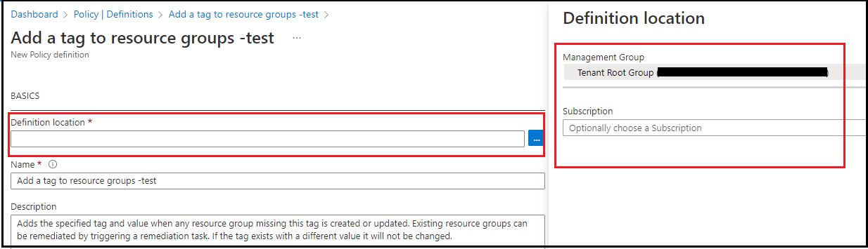

    3. Select "Definition location". If you have an Azure Management Group with multiple subscriptions in it, you can select the location as "Management group". This would help you assign this policy to multiple subscriptions OR apply to all subscriptions in the Management Group. Alternatively, you can choose to save it in a particular subscription instead.

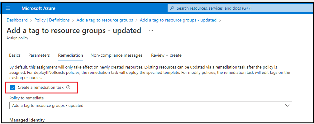

    8. On "Remediation", select "Create a remediation task". This is to add tags on existing resources based on this policy. By default, the policy only adds tags to new/updated Resource groups and shwos the existing ones as non-compliant. Remediation helps to modify existing non-compliant resources based on a policy. You can see this link for details on remediation in Azure Policy. If you do not see the option to select "Create a remediation task", you might have selected the scope of assignment as "Management Group". In this case, you will have to create remediation task later, once the policy is assigned. Please see this link for details.
    9. Next --> Next --> Create
