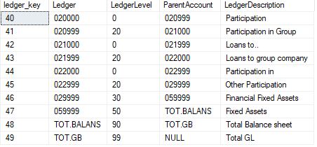

We have a table LedgerAccount with the parent-child relationship as:
CREATE TABLE [dbo].[LedgerAccounts](
	[ledger_key] [int] NOT NULL,
	[Ledger] [nvarchar](12) NULL,
	[LedgerLevel] [int] NULL,
	[ParentAccount] [nvarchar](12) NULL,
	[LedgerDescription] [nvarchar](30) NULL,
 CONSTRAINT [PK_LedgerAccounts] PRIMARY KEY CLUSTERED
	[ledger_key] ASC
)WITH (PAD_INDEX = OFF, STATISTICS_NORECOMPUTE = OFF, IGNORE_DUP_KEY = OFF, ALLOW_ROW_LOCKS = ON, ALLOW_PAGE_LOCKS = ON) ON [PRIMARY]
) ON [PRIMARY]
INSERT INTO [dbo].[LedgerAccounts]
  -     VALUES (40, '020000', 0, '020999', 'Participation'),
  - (41, '020999', 20, '021000', 'Participation in Group'),
  - (42, '021000', 0, '021999', 'Loans to..'),
  - (43, '021999', 20, '022000', 'Loans to group company'),
  - (44, '022000', 0, '022999', 'Participation in'),
  - (45, '022999', 20, '029999', 'Other Participation'),
  - (46, '029999', 30, '059999', 'Financial Fixed Assets'),
  - (47, '059999', 50, 'TOT.BALANS', 'Fixed Assets'),
  - (48, 'TOT.BALANS', 90, 'TOT.GB', 'Total Balance sheet'),
  - (49, 'TOT.GB', 99, 'NULL', 'Total GL')
LedgerLevel defines the level in the hierarchy. The parent 059999 is on the highest level( in this example i.e. 90) and 0 is the lowest level child node.

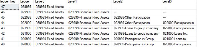

I need to create a table/structure/tmp.table using the hierarchical relationship in the above table as follows :
Here, we can parameterize the number of levels and level ids.
Following is the query I have tried without considering the parameterization and assuming the number of levels = 4.
How can I achieve the same without hard-coding the number of levels and levels id?
I am a newbie in SQL and have basic knowledge of it.

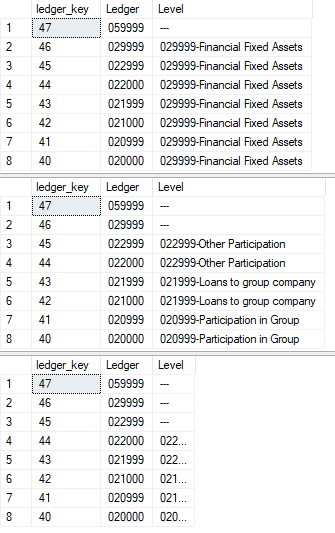

  1. EchoLiu-MSFT 14,626 Reputation points
    2020-09-29T07:04:20.323+00:00
    Hi @Anonymous
    Please refer to:
     create PROCEDURE [dbo].[Ledgerview] (@LedgerLevel int)as
    	 WITH LedgerAccountstree AS
             SELECT
                 ledger_key,
                 Ledger as CurrLedgerCode,
                 Ledger,
                 Ledger as Lvl0Code,
                 LedgerDescription as Lvl0Description,
                 cast('-' as nvarchar(12)) as Lvl1Code,
                 cast('-' as nvarchar(30)) as Lvl1Description,
                 ParentAccount,
                 LedgerLevel
             FROM
             WHERE
                 LedgerLevel = 50
             UNION ALL
             SELECT
                 [dbo].[LedgerAccounts].ledger_key,
                 LedgerAccountstree.CurrLedgerCode,
                 [dbo].[LedgerAccounts].Ledger,
                 LedgerAccountstree.Lvl0Code,
                 LedgerAccountstree.Lvl0Description,
                 case when [dbo].[LedgerAccounts].LedgerLevel = @LedgerLevel then [dbo].[LedgerAccounts].Ledger else LedgerAccountstree.Lvl1Code end as Lvl1Code,
                 case when [dbo].[LedgerAccounts].LedgerLevel = @LedgerLevel then [dbo].[LedgerAccounts].LedgerDescription else LedgerAccountstree.Lvl1Description end as Lvl1Description,
                 [dbo].[LedgerAccounts].ParentAccount,
             FROM
             JOIN
                 LedgerAccountstree
                 ON LedgerAccountstree.Ledger = [dbo].[LedgerAccounts].[ParentAccount]
        SELECT ledger_key,Ledger,Lvl1Code +'-'+ Lvl1Description as Level
         FROM
                LedgerAccountstree
    EXEC [dbo].[Ledgerview] @LedgerLevel = 30
    EXEC [dbo].[Ledgerview] @LedgerLevel = 20
    EXEC [dbo].[Ledgerview] @LedgerLevel = 0
    drop procedure [dbo].[Ledgerview]
