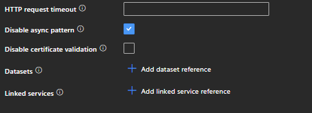

    I had the same issue. Try the Disable async pattern option.
