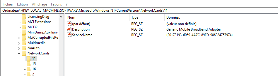

  1. Castorix31 90,521 Reputation points
    2022-12-01T08:55:38.927+00:00
    You can see this thread Get the IP address of the physical network card ?
    (with HKEY_LOCAL_MACHINE\SOFTWARE\Microsoft\Windows NT\CurrentVersion\NetworkCards)
