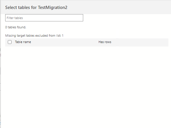

i would like to try a SQL Server Database Migration to Azure SQL Database with Azure Data Studio.
The Problem is that i never seen the Tables from the local SQL Server which i would like to Migrate.
For my Test i have installed an SQL Express 2019 Server with one Database.
Here the Picture of my Problem:
I see nothing Tables from my local SQL Express Server.
Also i cant continue with the Wizzard to move the Databases.
Can someone help me?

  1. Phil 291 Reputation points
    2022-12-02T07:52:01.873+00:00
    Problem is solved.
    The Tables are under Missing.
    The first Step i must to do is to prepare the Schema on the Target Database.
    I used the "Project Extension at Data Studio" for the Schema Configuration on the Target Database.
    After this i can use the Tables in Azure Data Studio.
    Thanks.
    Regards,
    Phil
  2. GeethaThatipatri-MSFT 29,587 Reputation points Microsoft Employee Moderator
    2022-12-01T20:04:07.127+00:00
    Hi, @Phil Thanks for the question and for using the MS Q&A platform.
    I want to make it confirm with you that you are clicking on Azure SQL Migration extension and selecting the list of databases.if not please make sure you are selecting the right extensions.
    Regards
