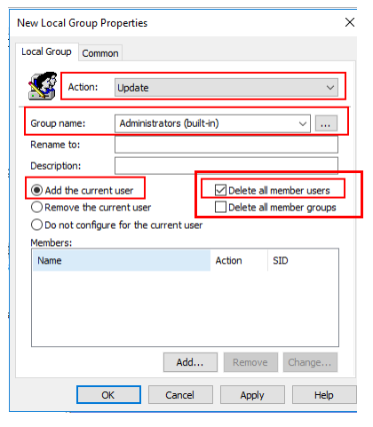

    Another option to manage local group membership is to use Group Policy Preferences (GPP).To configure Group Policy Preferences, simply open a GPO and navigate to Preferences, then expand Control Panel Settings. It is under both Computer Configuraion and User Configuration.
    When you right-click and create a new policy, you will have the option to add, remove or even modify local group membership. For example:
    So to check this issue, we could run gpresult /h C:\report.html  to get the GPO report and then check whether the above two settings are configured.
