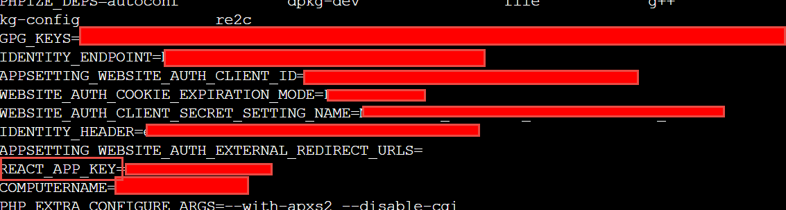

My application on dev is working fine.I can retrieve the variable after check by using printenv
By the way, I also check the env variable on PRD using printenv and It's also show me the correct environment variable.
But after I debug in the application seem like process.env.REACT_APP_* will be undefined. I'm not sure what I missing here.
