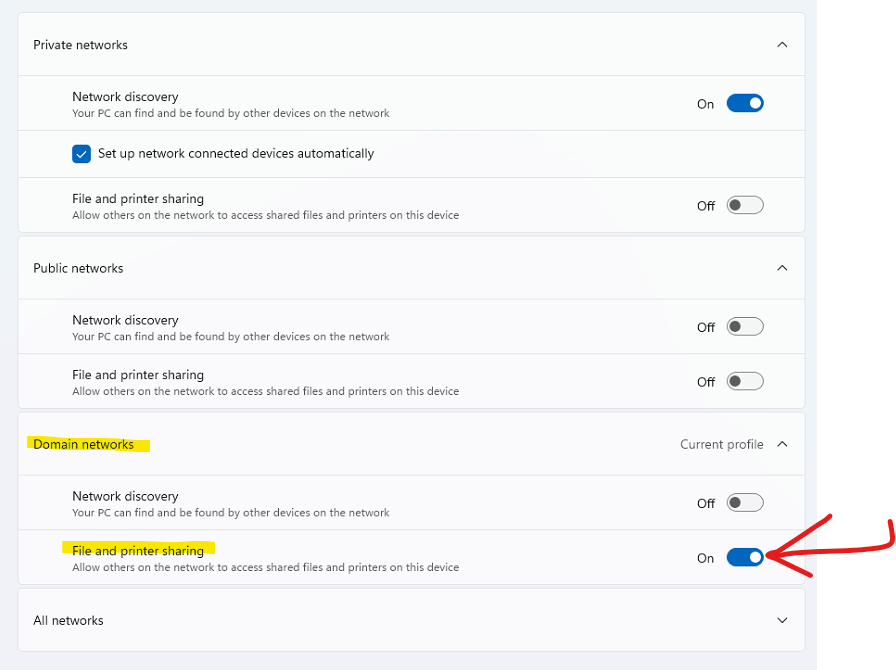

Everything was working fine until the most recent Windows 11 update (Windows 11 version 22H2). After the update, when users try to scan a document and save it to any shared drive, they are no longer able to see any shared drives when trying to browse for a shared drive to save documents to. Remember, this only happens when using PaperStream Capture. I can see all mapped shared drives in File Explorer (see image below).
They only have access to C:\Users\Public\Documents.
PaperStream Capture appears to have lost access to or permission to any shared drives. Also, this only happens on a domain use profile. If I log into a local profile, I can see all drives when using PaperStream Capture.
All my shared drives present when I check File Explorer.
No access to any shared drives only C:\Users\Public\Documents.
When I click on Browse, I only see Desktop as a folder to save scanned documents.
All my shared drives are present when I check File Explorer.
This is the way it supposed to look like on a computer that I had not updated to the Widows 11 update (Windows 11 version 22H2)
If I update windows 11, I will lose access to the shared drives just the picture above, already happened on a second computer that I updated (Windows 11 version 22H2)
Sharing permissions are set correctly. I tried different modes to no avail.

  1. PrimoQ 21 Reputation points
    2022-12-07T18:59:14.297+00:00
    Here is a little update. I found a workaround.
    Even though it's not the ideal solution, I discovered that if I erased the domain account from the DC and then created the identical user, I was now able to see all the shared drives.
    Although I am aware that this is not the ideal answer, it will work for the time being.
