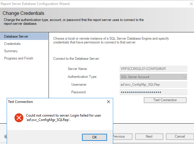

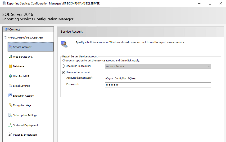

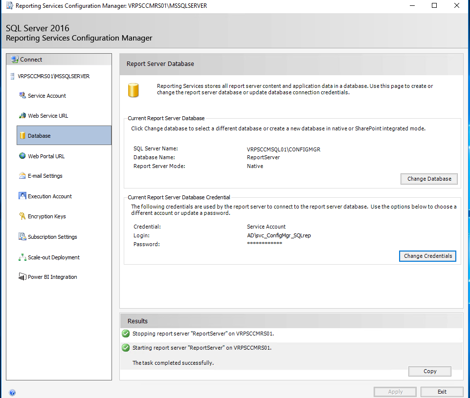

I changed:
  • SQL Server Reporting Services (MSSQLSERVER)
  • Reporting Services Configuration Manager:
    a. service account
    b. database - nothing changed !!
    but I was not able to change it... I do not see the "Service account" option in the drop down list

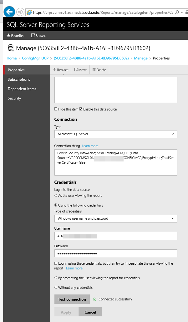

Also I changed the password on the Datasource and the "Test connection" was successful.
I clicked "Apply" but I never see any result "applied" ... I do not see any "OK" or "Saved" to confirm the new password is picked...

    for clarity, you don't change the data source password from Ssrs website but from within the configmgr console.

  2. Duchemin, Dominique 2,011 Reputation points
    2022-12-07T15:58:20.39+00:00
    Hello,
    I think it is the one I missed. I checked Administration > Overview > Site Configuration > Servers and Site System Roles > Reporting Service point
    I saw the account but no field for the password? as it is just a change password should I remove the current account and then readd it might ask for a password at that time?
    I checked also:
    https://learn.microsoft.com/en-us/troubleshoot/sql/reporting-services/best-practices-change-service-account?source=recommendations
    Resolution:
    I removed the account then add it back with the new password.
    Restart services on the Primary Server
    • SMS_EXECUTIVE
    • SMS_NOTIFICATION_SERVER
    • SMS_SITE_COMPONENT_MANAGER
    • SMS_SITE_VSS_WRITER
    and now everything is working...
