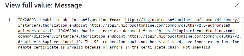

    IDX20803: Unable to obtain configuration from: 'https://login.microsoftonline.com/common/discovery/instance?authorization_endpoint=https://login.microsoftonline.com/common/oauth2/v2.0/authorize&api-version=1.1'. IDX20804: Unable to retrieve document from: 'https://login.microsoftonline.com/common/discovery/instance?authorization_endpoint=https://login.microsoftonline.com/common/oauth2/v2.0/authorize&api-version=1.1'. An error occurred while sending the request. Unable to write data to the transport connection: An existing connection was forcibly closed by the remote host.. An existing connection was forcibly closed by the remote host.
  4. Prasad, Raji 10 Reputation points
    2023-12-08T10:10:37.9133333+00:00
    The app was referencing an expired SSL certificate from the server (VM in azure) and when we removed the expired certificate the issue got resolved.
