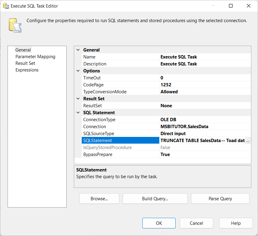

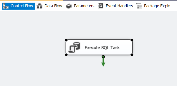

Have flat file in one server and have created SSIS package in different server. Am trying to load data from flat file to SQL database using SSIS package and inside package am using bulk insert task to insert data to table.
when am trying to execute, am getting access denied error or resultset not set properly error
Could anyone help on this ?

  2. Bala Narasimha Challa 466 Reputation points
    2022-12-07T16:04:33.15+00:00

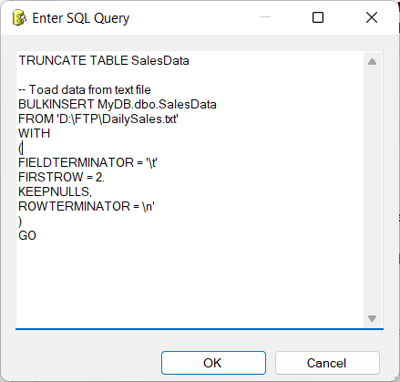

    Error Message:
    -load " failed with the following error: "Cannot bulk load because the file "D:\FTP\DailySales.txt'" could not be opened. Operating system error code 5(Access is denied.).".
    Possible failure reasons: Problems with the query,
    "ResultSet" property not
    set correctly, parameters not set correctly, or connection not established correctly.
    SQL Script
    TRUNCATE TABLE SalesData
    -- Toad data from text file
    BULKINSERT MyDB.dbo.SalesData
    FROM 'D:\FTP\DailySales.txt'
    WITH
    FIELDTERMINATOR = '\t'
    FIRSTROW = 2.
    KEEPNULLS,
    ROWTERMINATOR = \n'
    GO

  3. ZoeHui-MSFT 41,491 Reputation points
    2022-12-08T07:12:29.017+00:00
    Hi @Bala Narasimha Challa ,
    From the error message, it is a permission issue.
    Try to give SQL server account permission to access to the file.
