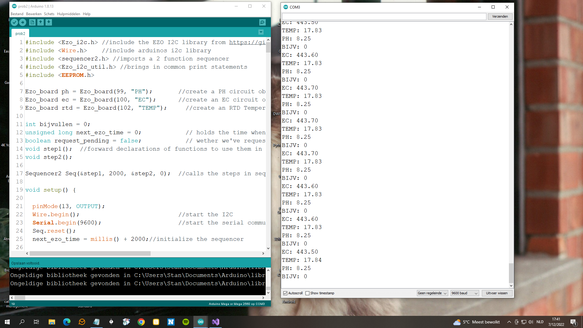

For several years I have been using a visual studio program to control my aquarium.
That worked perfectly until I connected new meters for measuring temperature,
acidity and conductivity of the water.
An Arduino mega displays the read values on the serial monitor.
The EC value should appear in TextBox3.Text
The TEMP value should appear in tb_temperature.Text
The PH value should appear in tb_pH.Text
The BV value should appear in TextBox4.Text
From there they can then be further processed to control the outputs of the Arduino mega board.
So the difficulty lies in sizing and writing the input data of the serial port.

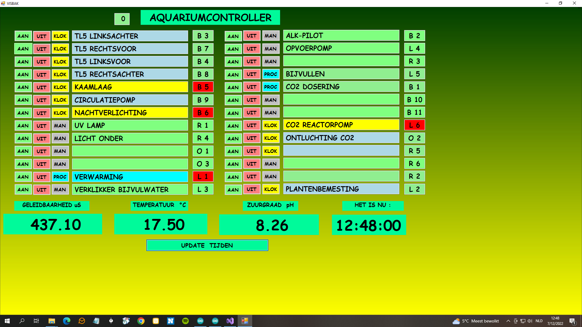

Enclosed are a few images of what arrives on the serial port, the vb program and a
screenshot of the result I sometimes get on the screen.
Also a picture of the error code: "the index is outside the matrix bounds".
Do any of you want to modify the vb class so that my "Aquarium Controller" works again ???
