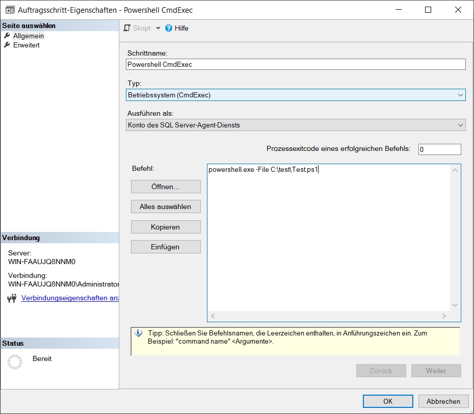

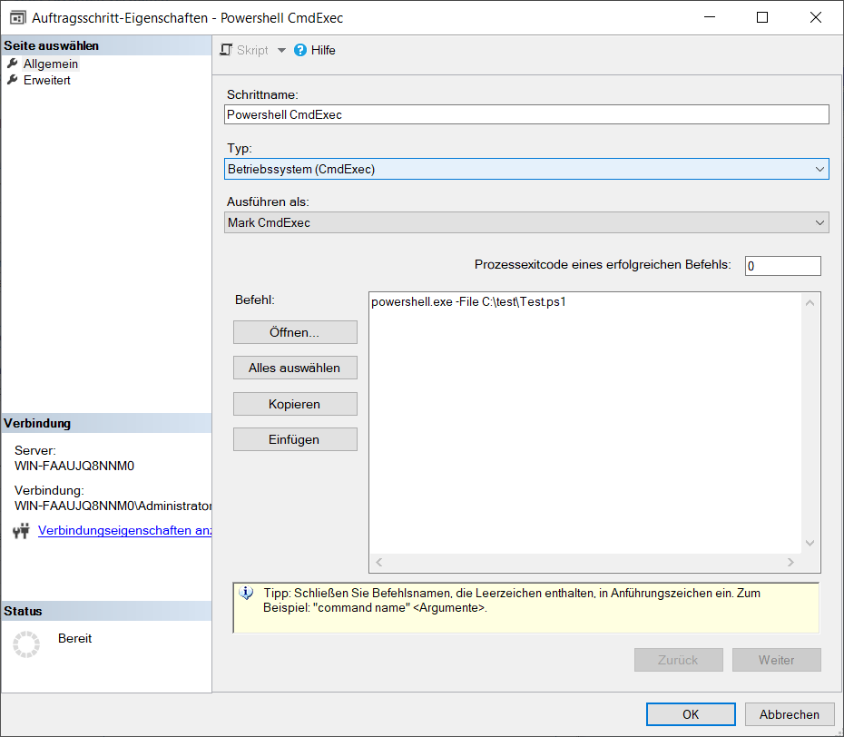

  2. Bjoern Peters 8,921 Reputation points
    2022-12-08T14:18:02.703+00:00
    Hallo @Kramomat
    I am not sure, but usually, the PoSh command line, which is started by the SQL Agent, is not 100% the same (at least not the same version) as you run from cmd (or START)...
    So I recommend reading this documentation as it might lead you to a solution... (you haven't posted a screenshot from your job step)
    You have to use a cmdexec step and not the PowerShell step and then start the correct version.
    https://learn.microsoft.com/en-us/sql/powershell/run-windows-powershell-steps-in-sql-server-agent?view=sql-server-ver16#CmdExecJob
