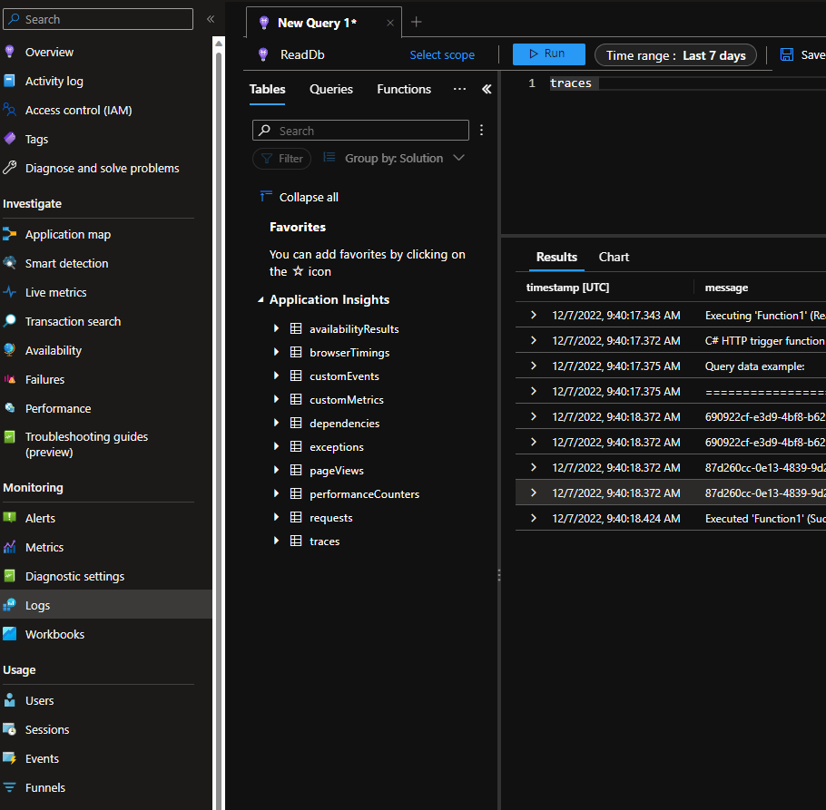

    You can view the logs in the monitor section of the Function app which has the invocation logs or you can also view the additional and granular logging in the log analytics workspace as well. In the log analytics workspace, you can run queries on the Traces table
