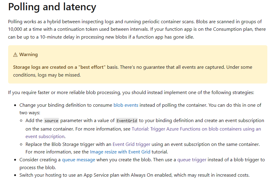

  1. MughundhanRaveendran-MSFT 12,506 Reputation points
    2022-12-19T06:29:43.753+00:00
    Function app running on consumption plan using the blob triggers rely on the Scale Controller to start up the app. The Scale Controller will poll the storage logs to determine if there are any changes/additions to the blobs. However, using the storage logs isn't 100% reliable.
    Reference : https://learn.microsoft.com/en-us/azure/azure-functions/functions-bindings-storage-blob-trigger?tabs=in-process%2Cextensionv5&pivots=programming-language-csharp#polling-and-latency
