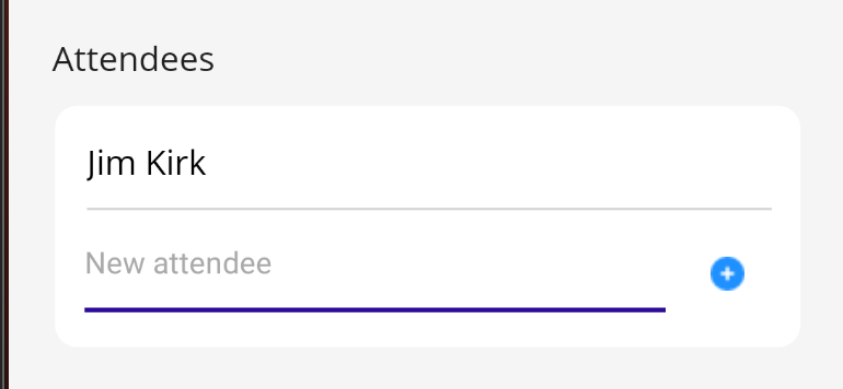

I have a ListView, which is populated by an add function like so:
(Fig 1: empty list)
(Fig 2: one item added)
Data binding with MVVM:
<ListView ItemsSource="{Binding Persons}">
      <Label Text="{Binding .}"
The Entry field is bound to:
[ObservableProperty]
public String attendee;
Persons is an ObservableCollection in the viewmodel:
public ViewModel()
            Persons = new ObservableCollection<String>();
        ObservableCollection<String> persons;
Button code:
[RelayCommand]
void AddPerson()
    Persons.Add(Attendee);
    Attendee = string.Empty;
Works on Android as shown above. Does not work on iOS, although the added persons are in the collection as they should. The list does just not get updated:
(Fig 3: list newer appears on iOS)

    I tried your XAML, and if I use it isolated (=> takes full height), it works. As soon as I wrap it in a Border element or have other elements above, it does not. So this seems to be the restricting element in the iOS implementation.

    The problem somehow solved itself, when I added a IsVisible property to my button. It seems, that this change in visibility does somehow trigger something to update the whole content that's wrapped inside the VerticalStackLayout.
