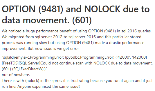

We noticed a huge performance benefit of using OPTION (9481) in sql 2016 queries. We migrated from sql server 2012 to sql server 2016 and this particular stored process was running slow but using OPTION (9481) made a drastic performance improvement. But now issue is we get error
“sqlalchemy.exc.ProgrammingError: (pyodbc.ProgrammingError) (‘42000’, ‘[42000] [FreeTDS][SQL Server]Could not continue scan with NOLOCK due to data movement. (601) (SQLExecDirectW)’)”
out of nowhere.
There is with (nolock) in the sproc. it is frustrating because you run it again and it just run fine. Anyone experinced the same issue?
Any help or links would be highly appreciated.
Thanks,
Ro
