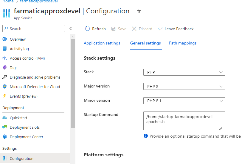

  2. Javier "Ciberman" Mora 1 Reputation point
    2022-12-26T17:37:11.587+00:00
    Hello. I have configured an startup script here:
    This is my startup script:
    root@be4e0b8db42b:/home# cat startup-farmaticapproxdevel-apache.sh
    #nginx start
    cp /home/site/mpm_worker.conf /etc/apache2/mods-avalilable/mpm_worker.conf
    cp /home/site/opcache-recommended.ini /usr/local/etc/php/conf.d/opcache-recommended.ini
    service apache2 restart
    # Deploy our amazing Laravel App
    cd /home/site/wwwroot/ && ./deploy-azure.sh
    # Installing cron
    apt-get update -qq && apt-get install cron -yqq
    (crontab -l 2>/dev/null; echo "* * * * * /usr/local/bin/php /home/site/wwwroot/artisan schedule:run 2>&1")|crontab
    service cron start
    How can I see the logs generated by my ./deploy-azure.sh script? I need to know if migrations have run succesfully or if there is any error or warning during deployment.
