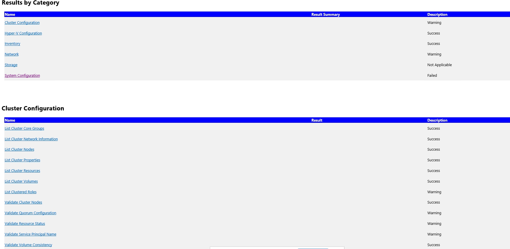

  2. Juthavut Vichitphan 1 Reputation point
    2022-12-28T07:56:54.72+00:00
    1. Please run Cluster Validation from Failover cluster manager.
      • I try to run validation and found an alarm about DNS.

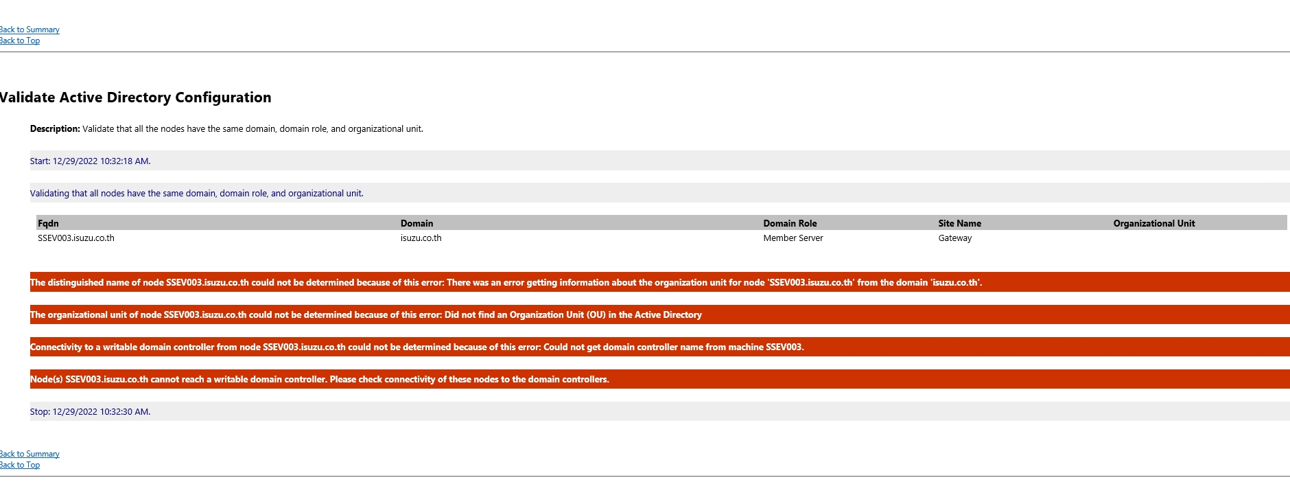

  3. Juthavut Vichitphan 1 Reputation point
    2022-12-29T03:44:10.353+00:00
    Please see error as attached file after validation cluster274649-1672285045246.jpg274635-1672285094455.jpg274626-1672285070749.jpg
