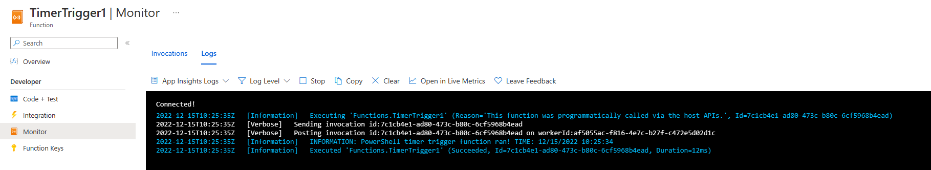

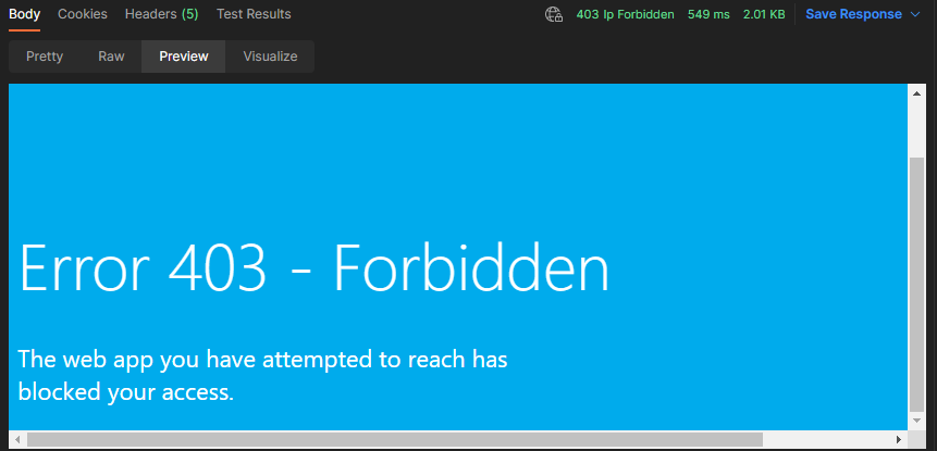

Hi to all,
I tryed to follow the doc: Manually run a non HTTP-triggered function, to test my timer Azure function, but I got: Error 403 - Forbidden everytime!
Same error if I try to test the function from the Azure Portal.
Can someone explain to me where is my fault?
Thanks.

    @Giostra Stefano Thanks for reaching out.
    Please make sure that you are passing the x-functions-key and Content-Type as the Header in your request and not as query parameters. The issue is reproduced if you are not passing the x-functions-key value correctly as header in your request. You need to pass _master key of your function app.
