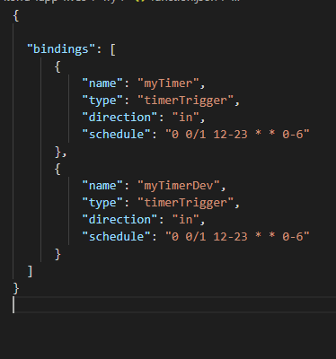

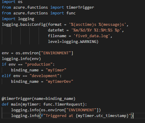

Second Method:
I added two binding variables in function.json as seen below. Then, with os.environ["ENVIRONMENT"], I choose the corresponding binding variable, for instance myTimerDev for the dev environment.
At python side below code
The Python code is not running, though.
Could you kindly let me know what I am missing or if there is a way for me to have two schedules that run based on the environment?

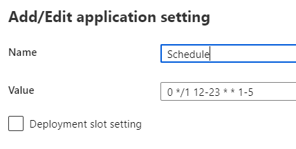

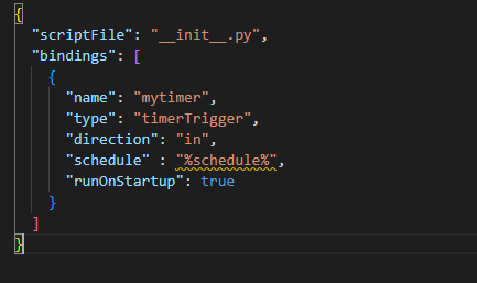

  1. Salehabanu Shaikh 1 Reputation point
    2023-07-25T12:43:54.21+00:00
    I solved it by myself. The application setting variable can be used in the code using % for example, "schedule" : %schedule%
