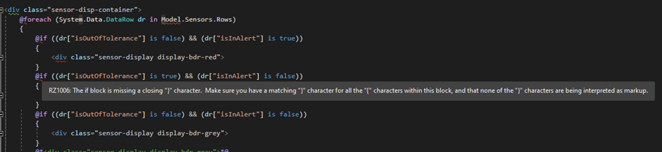

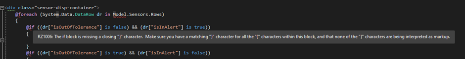

I was wondering whether anyone could help me with an issue I am having with templating in an ASP.NET Core Web App (not MVC). I am looping through a DataTable using the Model property in the html page and the below is fine:
Each row on the DataTable presents a temperature sensor, and for each loop, the temperature and other information from the sensor is displayed in it’s own div, which is styled as a box on the screen. I want to colour the border of each sensor box based on whether the temperature reading is out of tolerance or whether the sensor is in an alert state. There are boolean values within the DataTable to represent these and so I have added the code required and I get errors:
So this query would essentially display only one div with the ‘sensor display’ class, based on the condition. However it seems that the singular the fact that </div> is not include in each ‘if’ statement is a problem. I have not idea why the closing ‘}’ is not being picked up from the ‘foreach’ statement and two of ‘if’ statements, when they blatantly exist. And I also cannot understand why adding this code results in the ‘Model’ not existing in the current context.
I have a work around in place at the moment in that all of the code required for the page is repeated three times for each ‘if’ condition. However, this is not really a good solution when all I am changing is one line for each condition. So, I would like to know if anyone knows how to get this working. Also, where can I find documentation on the ASP.NET Core templating language; I cannot seem to find any guides online anywhere.
Below is the code. Any help would be appreciated.

    Hi @Chris Undritz ,
    From your code and description, the issue relates the above if condition and the div's end tag.
    I suggest you define a variable to store CSS class name, then in the if condition, you can set its value dynamically. Code like this (view the source code):
    Then the output like this:

  1. Viorel 125.6K Reputation points
    2022-12-16T18:06:45.267+00:00
    Check if this is acceptable:
    @if ((dr["isOutOfTolerance"] is true) && (dr["isInAlert"] is true))
        WriteLiteral("<div class='sensor-display display-bdr-red'>");
    @if ((dr["isOutOfTolerance"] is true) && (dr["isInAlert"] is false))
        WriteLiteral( "<div class='sensor-display display-bdr-amber'>" );
    @if ((dr["isOutOfTolerance"] is false) && (dr["isInAlert"] is false))
        WriteLiteral( "<div class='sensor-display display-bdr-grey'>" );
    WriteLiteral("</div>");
    Make sure that there is no "false-true" case, or add the if.
  2. Bruce (SqlWork.com) 81,971 Reputation points Volunteer Moderator
    2022-12-16T16:06:06.887+00:00
    The razor template only allow closed tags inside code sections. For example in the following if you need to close the div (</div>):
                 <div class="sensor-display display-bdr-red">
    Use the ifs set set variables for the class values rather than conditional begin tags
  3. Chris Undritz 41 Reputation points
    2022-12-19T11:52:25.097+00:00
    Thank you both @Anonymous and @Viorel ! Both solutions worked very well and I have upvoted both. I am going to use the solution where a variable is declared though, as it gives me more flexibility within the code I want to write. But again thank you both for your time on this.
