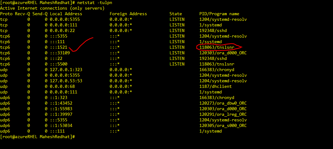

But when i am pinging from my windows PC, all the other ports(80,22,443) are connecting fine but not port 1521.
I have already set up inbound rules for windows firewall in my PC and VM side port 1521 is opened at Azure VM as well.
I have gone through lot of search but nothing could resolve the issue and and i am unable to connect my SQL Developer. Could somebody who is expert in this networking issues shed light on this?

    Are you able to connect to that port from inside the RHEL VM?
    Is there a local firewall on the RHEL VM that needs to allow traffic on TCP/1521?

    On your netstat results, I see that port 1521 is listening on tcp6 which is TCP on IPv6 address. Can you make sure that your service is listening on IPv4 address and then try again?
