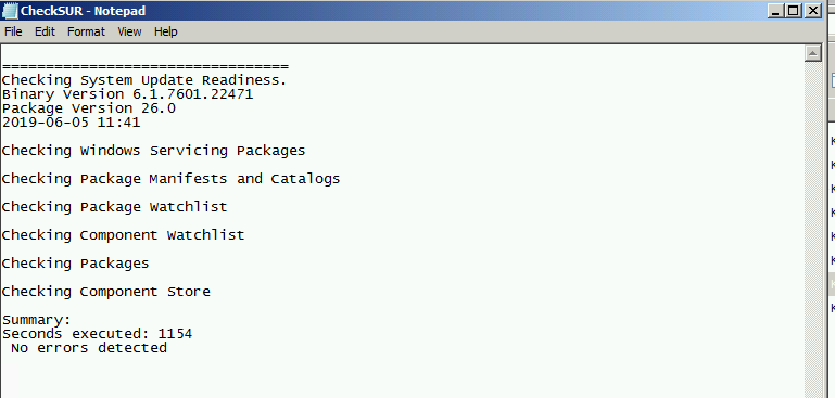

    2022-12-19T21:27:46.393+00:00
    Please run the system update readiness tool.
    https://www.catalog.update.microsoft.com/Search.aspx?q=KB947821
    Then post the results of;
    %SYSTEMROOT%\Logs\CBS\CheckSUR.log
  4. Vaughan Wickham 141 Reputation points
    2022-12-19T21:50:07.653+00:00
    @Anonymous
    Checking System Update Readiness.
    Binary Version 6.1.7601.22471
    Package Version 26.0
    2022-12-20 08:42
    Checking Windows Servicing Packages
    Checking Package Manifests and Catalogs
