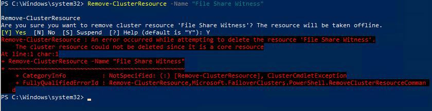

Hi I installed SQL Server 2019 on Windows 2019 and need to change witness share location to new location as per adviced from storage team. I configured with new location and up and running . old network share shows offline . I tried to delete from Fail-over cluster manager and failing to delete. Any one knows how to delete it

  1. Ashwan 536 Reputation points
    2023-01-24T05:21:09.77+00:00
    Hi resolved this issue
    step1: through Quorum configuration , select "do not confgure a quorum witness" and disabled
    step 2: offline the witness share from Failover cluster manager
    step3: remove the witness share from Failover cluster manager
    step 4: freshly configure new network location
  2. Limitless Technology 44,776 Reputation points
    2022-12-22T14:43:16.113+00:00
    Hello
    Thank you for your question and reaching out. I can understand you are having query\issues related to remove old witness share.
    Please try to reboot your Cluster nodes one-by-one
    Open cmd with elevated and type 'cluster res' to list out all of the resources. Copy the name of the failed FSW resource and then type:
    cluster res "<failed resource name>" /delete

  3. Ashwan 536 Reputation points
    2023-01-23T03:55:11.3333333+00:00
    hi I tried to delete the resource and end up with following issue.
    "the cluster resource could not be deleted since it is a core resource "
  4. Ashwan 536 Reputation points
    2023-01-23T03:56:51.15+00:00
    Hi sorry for the late reply and was on leave. I tried to delete and end up with error
