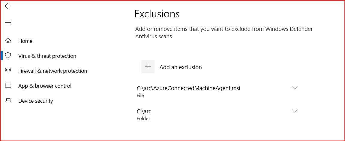

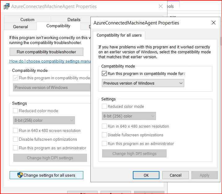

  3. Myint Myat 0 Reputation points
    2023-08-05T18:03:46.5066667+00:00
    I have found one solution for this.
    Delete the AzureConnectedMachineAgent folder under the location.
    Location >> C:\Program Files\AzureConnectedMachineAgent
    Location >> C:\ProgramData\AzureConnectedMachineAgent
    Copy AzureConnectedMachineAgent installer to C:\
    Installer > right click > properties> compalibility
    Select the check box for "Run this program in compatibility mode for" previous version of windows
    Also for all user
    Add arc installer file and folder to virus & threat protection exclusion list.
    Try installing Arc.
    It will work.
