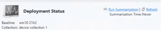

Since yesterday I am facing a strange Issue , deployment status for only OSD task sequence is not updating. Other deployment Status like Software Updates , Application Deployment is working fine.

    Are you referring to the Monitoring > Deployment status in the console?
    If yes, please try running summarization and refresh to see if the status information has been updated, if it not works, try recreating the deployment.
    However, if the issue persists, I recommend you use the SSRS reports instead of the console reports, because console reports may not give you correct/updated results and is slow as well. Here is a similar scenario for your reference: http://sccmist.blogspot.com/2016/09/status-information-is-currently.html
